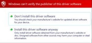

You may get the following message on the screen:
If the issue is with the digital signature, then disable driver signature checking option by booting the system in ADVANCED BOOT OPTIONS.
