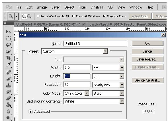

1) RESOLUTION
Open photoshop.
Click on Edit-> Preferences -> Units and Rulers.
Change the Rulers from cm to inches.
Enter units to points.
Enter 300 pixels/Inch in the ‘Print resolution’ tab.

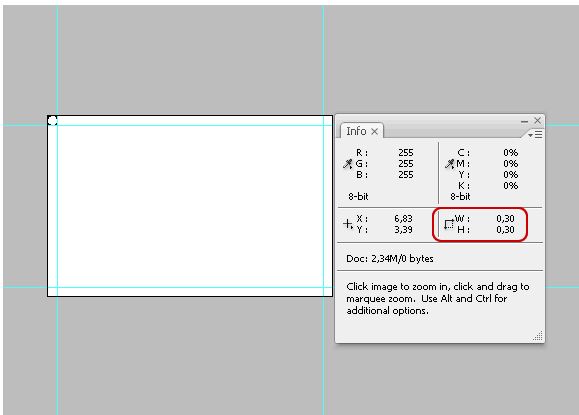

3) BLEED
It is the extra part required to be cut off.
It introduces a margin of error.
Use the Rectangular Marquee tool. Hold the shift button and draw a square.
Put the guides coinciding with the marquee edges.
