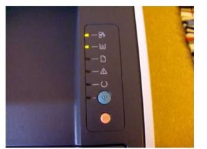

  1. At first, you need to check whether the printer’s warning light is on or not. If it’s on, then there is something wrong with the printer itself, and it needs maintenance.
  2. You must also not forget to check if the ink cartridge is empty. Sometimes the warning light is on as it tells you to replace the ink

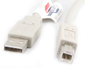

In case the printer still doesn’t work even after reinstalling the driver or the printer software, make sure the USB cable is still functional. When you connect your printer to your computer, your computer should be able to detect it. If you don’t see your printer on the system tray, try transferring the cable to a different USB port. If this doesn’t work, try using a different USB cable.
