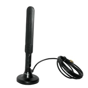

2.  Replacing the antenna with a high gain antenna.  Wireless routers have detachable antennas.  Depending on your router brand, you can purchase higher gain antennas that can increase the effective range of your wireless router.  An example is shown below:
