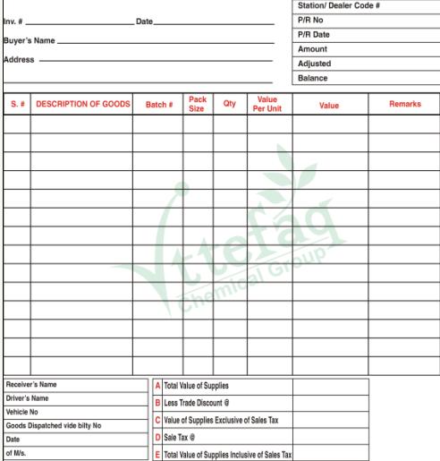

Blank lines required in crystal Report 8.5
This problem can be solved quite easily. Please post an image of the letter pad so that I can understand the problem in detail. Also let me know what software you are using for report generation and development.
Answered By 20 points N/A #91597
Here you are. Note, that the company letter head has been blanked out for security reasons. I am using Crystal Reports 8.5 with VB and SQL for report generation and development.
Crystal Reports with VB and SQL

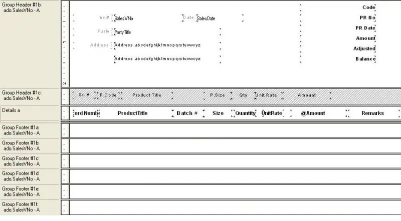

Answered By 10 points N/A #91600
Here's an image of the report design view. Perform all the tasks I have described in the last comment. You must Generate group headers on the basis of Sales/Purchase voucher no.
Answered By 20 points N/A #91601
Thank you so much. My problem seems to be resolving. I have added all the groups and set the formulas too.
But there is one pending issue: The report fields are not on the exact lines and exact places.
Can you help?
Answered By 10 points N/A #91602
Make sure that the line height of the details area and the added group headers is identical to the height of those in the letter pad.
You may need to modify these: use a trial-and-error method to fine tune your settings to match the letter pad exactly.
