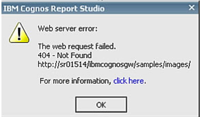

I am trying to insert a picture object into the report results in the web server error while using Report Studio in IBM Rational Common Reporting. What should I do now? Any idea
IBM Cognos report studio
Web server error:
The web request failed.
404 – Not found
http://sr01514/ibmcognosgw/samples/images/

Hi there Darrell M Son,
This problem can cause because of two reasons
1.   The image you are trying to insert is not in GIF or JPEG format
2.   Browser button performances a bit uncertain
You can solve this problem by following these steps
1st Go to the Rational Common Reporting Install Path (AppServerprofilesRationalInsightinstalledAppssus-or1lin01Node01CellIBM Cognos 8.earp2pd.warimages)
2nd Copy the image into image folder
Note – Some time the image folder won’t be there if so you need to create it
3rd Drag the image from the toolbox into the article
4th Access the image using this link http://server:9080/insight/images/Name of photo.jpg
Note – URL is case sensitive
If you follow these steps the problem can be solved
