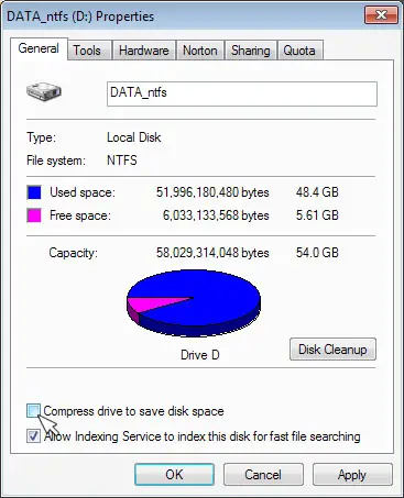

I think this is similar to error code “0x80070299” which means “The requested operation could not be completed due to a file system limitation.” According to a post in the Microsoft blog site, one possible cause for this error is when NTFS compression is enabled on the drive.
Since you are using drive P (35 GB) as a backup drive and backing up can mean copying huge files, this can cause problems when it reaches the target drive. When compression is enabled on an NTFS drive, compression is performed transparently. It means files are getting compressed as it reaches the target drive.
When compression is enabled on NTFS file system, compressing files larger than 30 GB may not succeed. So, to fix the problem, check your drive P if compression is enabled. Open Windows Explorer then right-click your drive P and select “Properties.” In “General” tab, check if “Compress drive to save disk space” is checked at the bottom. This means NTFS compression is enabled.
Uncheck this option to disable compression then click “OK.” See if this fixes the problem.
Another possible cause of the error is when the drive is heavily fragmented. You can use the Windows Disk Defragmenter to check if the drive is fragmented and then just defragment it.
