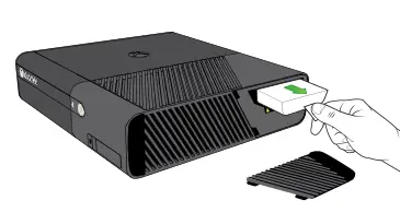

Follow these steps:
1. Power off the console and unplug all accessories.
2. Place the console horizontally.
3. On the right hand side locate the hard drive cover.
  locate-the-hard-drive-location
4. Take out the hard drive.
5. Now reconnect all the accessories.
6. Close the hard drive cover and turn on the console.
If the problem is still not resolved you can contact Xbox Online Service Centre with your Microsoft Account.

The error E68 represents hard drive malfunction. There is no actual solution to this error, but most of the forums said to unplug the hard drive, clean it and reattach it. The steps are given below.:-
1. At first you should turn off your console.
2. Then keep it horizontally.
3. On the right bottom side you should see the hard drive chamber
4. Slide release diagonally and you should be able to remove the hard drive.
5. Clean the dust off it and reinstall it.
6. If the problem still exists the only solution is to buy a new hard drive. You can contact the online service center from here.
