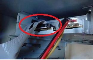

Did you tried unplugging the data cable and putting it back again? The problem is most likely the data cable is not properly attached to the floppy drive. Make sure that the cable pin of the floppy drive is attached to its back and to the input/output motherboard. The first Pin is most commonly near at the power connector of the floppy drive and then the red stripe of the data cable should be pointing at the power connector.

When floppy LED indicator is turned on always then the floppy data cable was plug incorrectly opposing to the pins in the motherboard or you have a bad floppy data cable. Turned off PC and unplug power cord. Locate your floppy drive when you the rear end of your floppy drive, unplug the data cable just flip it to opposite direction and replug the floppy data cable. Replug power cord and turn on again your PC.
If your computer is still using a floppy disk drive and the LED indicator is always on even if there is no disk inside, you need to check the cables inside your CPU. Shut down your computer then open the CPU case. Locate your floppy drive then disconnect all the cables. After this, plug the power supply back to the floppy drive then turn on the CPU.

If the LED indicator turned off automatically, shut down your computer again then connect the ribbon cable or data cable back to the floppy drive. Turn on the CPU again then check the LED indicator. It should turn off automatically after initialization. If the LED indicator stayed on, try using a different floppy drive ribbon cable or buy a new one.

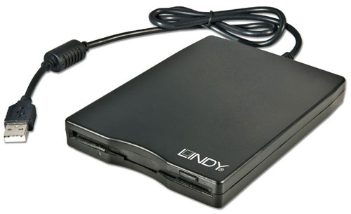

In this case, disable your floppy drive in the BIOS and just use an external floppy drive that you can plug on the USB port. This is more convenient than using an internal floppy disk drive.
