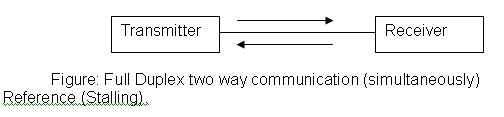

FULL-DUPLEX TRANSMISSION:-
In full duplex transmission, signals are transmitted in both directions; both stations can receive and send the data at the same time (simultaneously). This type of transmission is also referred to as two-way simultaneous. Full duplex transmission required two independent channels, one for receiving the data and one for transmitting the data.
