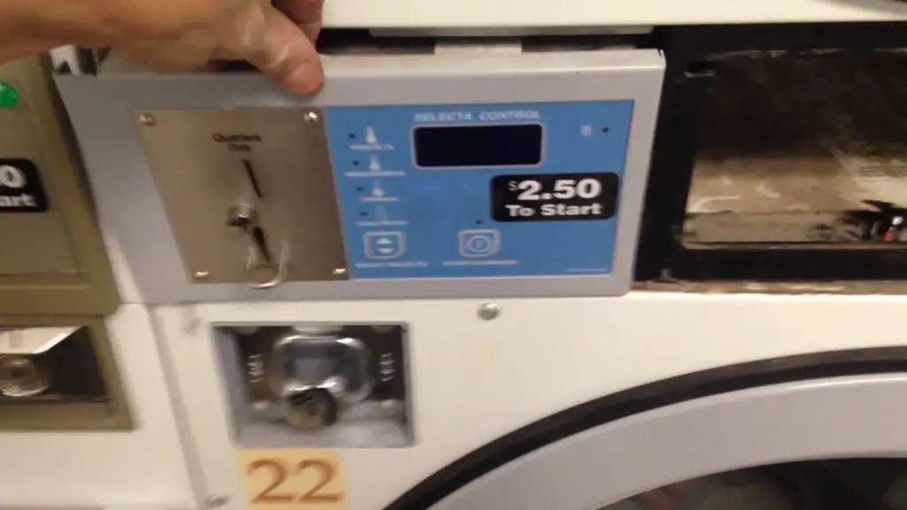

I am using a washing machine of wascomat but I am facing some issues. I observed that the wascomat dryer error code 8 is appearing. But what is the meaning of this error code?

The error E 08 as overheating of the air. This is probably the point of sale that is contaminated with lint or some other material. Remove the breather hose, vacuum the lint filters, clean the outlet hose and reset the machine. If the dryer is connected to other dryers in a multi-event system, it may be necessary to clean the vent lines to avoid the problem.
