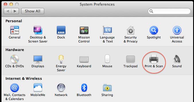

For Mac, click on the Apple menu and select System Preferences then click “Print & Scan”. See image.

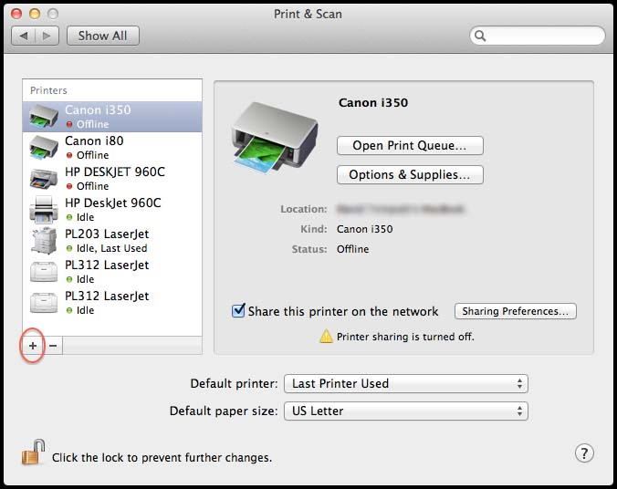

To add a printer, click on the plus sign “+” on the left panel. See image.

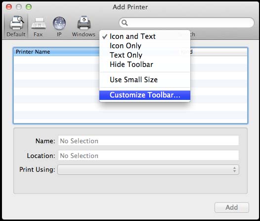

On the next screen, right-click on the toolbar at the top and select Customize Toolbar. See image.

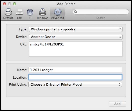

In Type dropdown menu, select “Windows printer via spoolss”. See image.

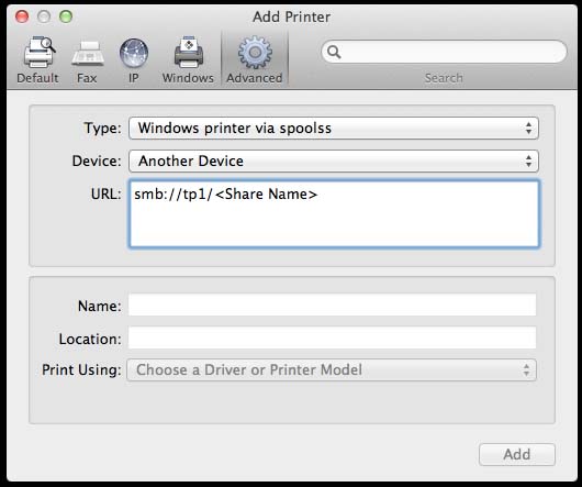

In URL, enter the server and share name of the printer using the following format: “smb://Server/ShareName”. See image.
Specify the Name and Location of the printer. See image.
In Print Using dropdown menu, pick Select Printer Software. Make sure to select the correct software for the printer because the software is dependent on the printer. See image.
Once the correct printer software has been selected, click OK, Add, and then OK. And you’re done. When you want to use it and it asks for verification, just enter your administrator username and password to continue.
