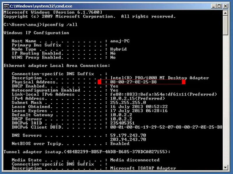

1. Open up the Start Menu and then type in cmd to open the Command Prompt.
2. Inside the Command Prompt enter the following command : ipconfig /all
3. Press Enter and list full of information will appear inside the Command Prompt.
4. This is what you need to select:
5. That is your MAC address. Give it to the network administrator he will give you access to the LAN network in about 3 hours or so.
