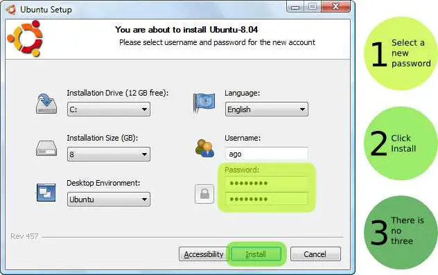

I think you have successfully installed Linux Ubuntu on your computer using Wubi and at first I thought you are installing Linux Ubuntu on a freshly formatted computer until I saw Wubi in your post. I then realized that there is another operating system running on your computer. Wubi is the official installer used for installing Linux Ubuntu on a computer running on Microsoft Windows. Wubi allows the easy installation and removal of Linux Ubuntu as if it was just an ordinary application that can be installed and uninstalled.
But remember that Wubi doesn’t work on a computer that uses the UEFI firmware or has the Windows 8 logo. But if in case you fall in this situation, use the 64-bit flavor of Linux Ubuntu and install it directly to the partition instead of using Wubi. To download the latest version of Wubi, visit Download Windows installer for Ubuntu Desktop. Installing Linux Ubuntu using Wubi is very simple. First, download the latest installer from the link above and then run it on your computer. Insert your password for the new account, change the settings like the disk space and others, and then click Install.
The whole installation is fully automatic. This is the screenshot of the Wubi installation screen when installing Linux Ubuntu.
