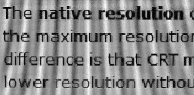

What's screen size of your monitor?  Unlike CRT monitors, LCD monitors have what is known as a "native resolution" or a single fixed resolution.  This native resolution usually depends on the size of the monitor.  15" LCD monitors typically has a native resolution of 1024×768.  If you set the resolution to 800×600, you get fuzzy text and pictures like the photo below shows.
