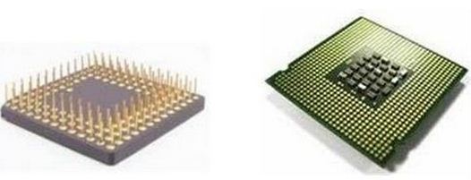

PGA CPU form: Take the CPU by its side and align it on the socket holes. If it doesn’t fit, it means the CPU is not in the correct position with the socket.
PGA CPU with socket holes
Take note: Only the PGA CPU has pins and the socket has holes.
LGA CPU form : Again, take CPU by its sides, then align unit in the socket housing frame. Afterwards, close the load plate and secure the load lever with its hook.
LGA socket pins are too fragile
Take note:
LGA socket pins are too fragile. Do not move it with too much pressure or it will be unusable when broken.
