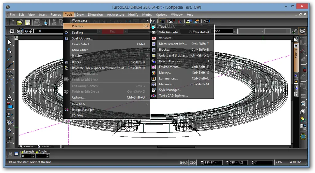

Hi! Today when I opened TurboCAD 20, I noticed that the screen looks different and some tools have disappeared, and the Delete key is not working. How can I fix this problem?
Answered By 10 points N/A #320733
Screen Looking Different After Opening TurboCAD 20
To fix this problem in TurboCAD 20, the first thing you should do is to reset the styles. To do this, follow the steps below-
  • Go to Tools.
  • Click on Customise.
  • Select Default.
It will reset the styles, but you have to customize the screen again. If there is also something wrong with lines, then follow steps below-
  • Go to top of the screen and click on the Standard view icon, i.e., World Pan.
If it is not improving the problem, then open the standard views pallet and click on the Pan icon.
