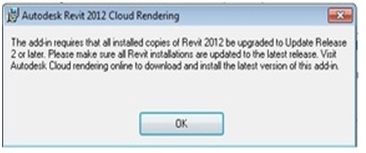

I downloaded and when I run the installer, a dialog box opens showing me the following message:
Autodesk Revit 2012 Cloud Rendering
The add-in requires that all installed copies of Revit 2012 be upgraded to Update Release
2 or later. Please make sure all Revit installations are updated to the latest release. Visit
Autodesk Cloud rendering online to download and install the latest version of this add-in.
                                                      OK
Has anybody else experienced the same? If yes then kindly tell me what to do next after this dialog box appears?

Hello Dawn Hardwick!
The problem here is that the add-in which you are trying to install only works for Revit 2012 Update 2.
You can update your pre-installed Revit from the following link:
Here you will find both Update 1 and Update 2, in case if you haven’t updated already.

Hello Dawn,
Have you checked whether you have installed the latest add-in to support it? Well, if not so then try and download the latest add-in from the source website. You can find the add-in after you log-in to their web portal: https://gallery.autodesk.com/a360rendering/projects
Click the New Rendering tab and on the right you shall see the download button.
