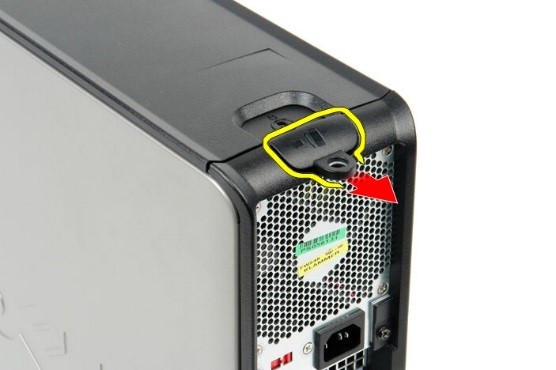

I want to remove both of the side panels from my Dell Optiplex 755 but I am not able to. Can someone explain to me how it is done? Are there any special tools that I must have?

In order to remove your side panels locate the cover release latch. The illustration  below depicts the location of the cover release latch. Slide the release latch back as you lift the cover.  Grip the sides of the computer cover and swing the cover up. Remove the cover from the hinge tabs and set it aside.
