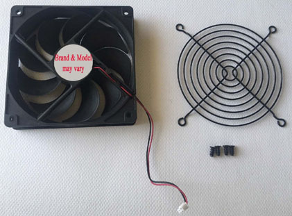

If your power supply’s cooling fan is starting to become noisy, it can have a big effect on the power supply itself. It can cause heating to the power supply because the cooling fan may no longer rotate at its default speed. There are two ways to fix the problem with the cooling fan. First, you can apply lube on the cooling fan to lessen the noise it creates.
The other way is to simply buy a new cooling fan for your power supply since cooling fans are just cheap to buy. To make sure you are buying the right size for your power supply, you can remove the cooling fan from the power supply. This is probably necessary if you are not using a normal tower CPU.
But if your CPU is the standard tower-type, you no longer need to remove the cooling fan out of the power supply because their power supply has the same built. You just need to buy a new power supply cooling fan like this one from eBay: 120mm 2pin Power Supply Replacement Cooling Fan.
