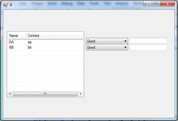

I'm having a problem using arrays in VB.NET.
Here's the thing:
This is the initial design of the form during design time. What I want to do is repeatedly create a combo box and a text box for every row in list view.
Here's how it looks like at runtime; since there are two items in list view, there will be two combo boxes and two text boxes:
Now here's where I lost it: the text of the text box will depend on the item chosen from the combo box. Say, if  Good  is selected from the combo box, $10 should be placed in the text box. What happens is that when I choose Good from the second combo box, the $10 still appears in the first textbox. This, I think, is where I lost it. The $10 appears on the  first textbox because I wrote TextBox1.Text = $10; what should I write to call the second text box(created dynamically in runtime)?
        If cbo.Text = "Good" Then
            TextBox1.Text = "$10"
        End If
Here's the whole code, take a look:

Answered By 0 points N/A #125135
Problem in using control arrays in VB.NET
Hi There,
Here is a solution for it:
Please understand the logic; it's more important
I have done some changes to your code:
1.Textbox is named to txt1 and combo box is named to cbo1 (for ease of reference)
2. The code is changed appears in bold.
Please check this out and if this works, you can improve more on the logic.
Thanks
Dipendra Shah
The changed code is :
