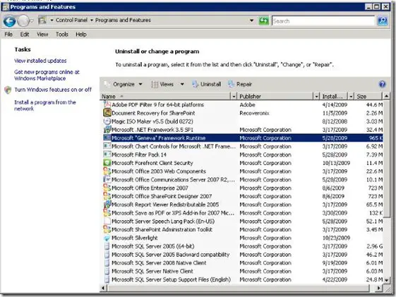

The reason you are facing this error is because of improper installation of the Geneva framework. To install Sharepoint 2013 on your computer you need to have Geneva framework pre-installed. It looks like the framework is not working correctly on your computer. To reinstall the Geneva framework follow the steps below:
1. Go to Control Panel on your computer and select the "Uninstall program" button.
2. Locate the Microsoft Geneva Framework in the list of programs and uninstall it. See the screenshot below:
3. After you uninstall, restart your system and then reinstall Geneva framework with the default settings.
Now, you will be able to install Sharepoint on your computer.
