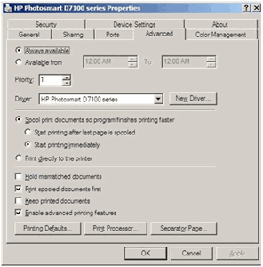

Please try this and see if it works for your Samsung 3471nd printer. Open printer and fax, I am not sure which system you are using so if it is Windows XP click the start button the n click on printers and faxes, if it is a Windows Vista then click the starting icon then go to click the control panel then double click on printers and faxes. If you are using Windows 2000 then click start then click on the control panel then double click on the printers and faxes. After that step right click your product the click on properties then click on the advanced tab click on the separator's page. In the separator's page's dialog box delete all the templates listing in the box then click ok. This if applied well will help you sort your problem and fix it.
