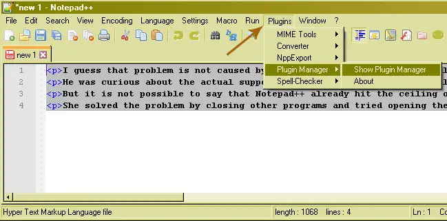

If you are using Notepad++, installing a plug-in is made easy through its Plugin Manager plug-in which is installed by default. If the plug-in you are trying to install triggered that error, you probably haven’t updated Notepad++ yet.
The plug-ins used in Notepad++ are being updated from time to time and if you are not updating Notepad++, the plug-in you install may no longer be compatible with your current version. In your case, it would be better to update Notepad++ to the latest. Go to Notepad++ Home to download the latest version. Once downloaded, run the installer to upgrade your existing version to the latest.
The latest Notepad++ already comes with the latest version of Plugin Manager, version 1.3.5. Now, check if the plug-in you installed previously that triggered the error is up and running. In Notepad++, click Plugins menu. The plug-in should appear anywhere on the list. By default, Notepad++ has the following plug-ins installed:

In my Notepad++ I installed the Spell Checker plug-in and it appears underneath the Plugin Manager. If there is still something wrong with your plug-in, try reinstalling it. Click Plugins then point to Plugin Manager and select Show Plugin Manager.
In Plugin Manager window, select Installed tab. Check the plug-in you want to reinstall and click Reinstall. Wait until it is finished then restart Notepad++. The example below reinstalls the Spell Checker plug-in. See if this fixes the problem.
