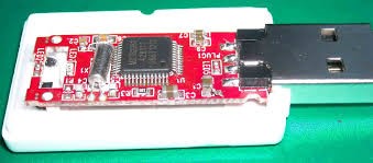

Pen drives are solid state drives and are mostly concealed.
1. Check for any openings. If there are some and water has gone into them then you should go to a service center.
