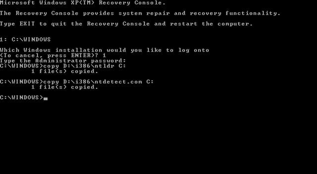

The message “NTLDR is missing Press Ctrl+Alt+Del to restart” is normally thrown when a computer running on Windows XP, Windows Vista, Windows 7, Windows 8, Windows 8.1, and Windows 10 is unable to boot the computer. This message is thrown if the NTLDR is not found on the root of the system drive or is corrupt. There are several reasons why this error is thrown.
One reason is if the computer is booting from a non-bootable hard drive. Another reason is if the NTLDR file or any of its related files (NTLDR, NTDETECT.COM, and Boot.ini) are corrupt or missing from the root of the system drive. It is also possible to get this error if the active partition on the hard drive is configured incorrectly.
You can also get this error if the root of the system drive has too many files in it. One way of fixing it is by replacing the NTLDR and NTDETECT.COM files using the Windows installation media. If you are using Windows XP, insert the Windows XP setup CD on the optical drive and restart the computer from the disc.
Press any key to boot from the CD. When you see the Windows Options menu, press “R” to access “Repair Console”. Next, when you are prompted with “Which Windows installation would you like to log onto”, press “1” and then type your administrator password. Enter without quotes “copy D:i386ntldr C:” then hit Enter.
This will copy the original “NTLDR” file from the CD to the root of your system drive. After this, enter without quotes “copy D:i386ntdetect.com C:” then hit Enter. This will now copy the original “NTDETECT.COM” file from the CD to the root of your system drive. Note: “D:” is the drive letter of your Windows setup CD and “C:” is the drive letter of your system drive.
If your optical drive is not letter D, replace “D:” with the correct drive letter of your optical drive, for example, “E:”. After copying the files, remove the disc from the optical drive and restart your computer. See if this fixes the problem.
