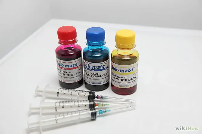

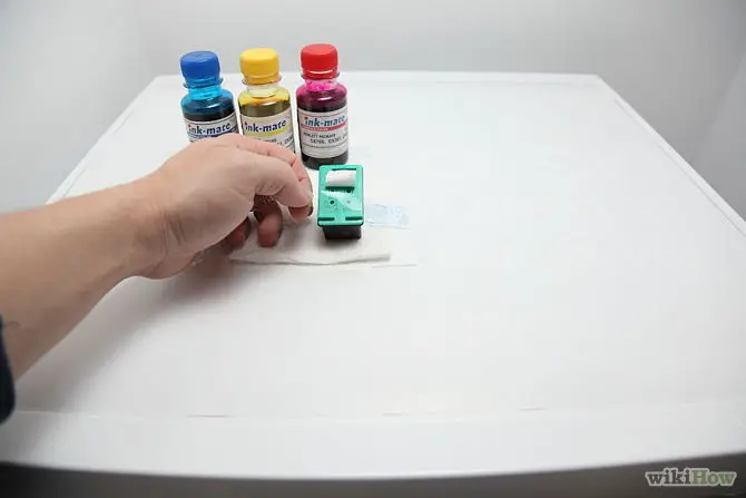

1. You need to buy an ink refill kit. This kit consists of the ink (in bottles) and the syringes needed to inject the ink into the cartridge.
Precaution: Please ensure that the ink refill kit you are buying is compatible with the ink cartridge you are attempting to refill.

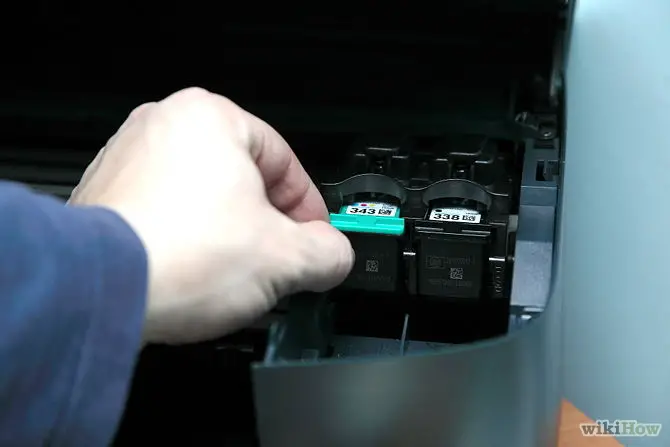

2. Next, you need to remove the empty ink cartridge from the printer.

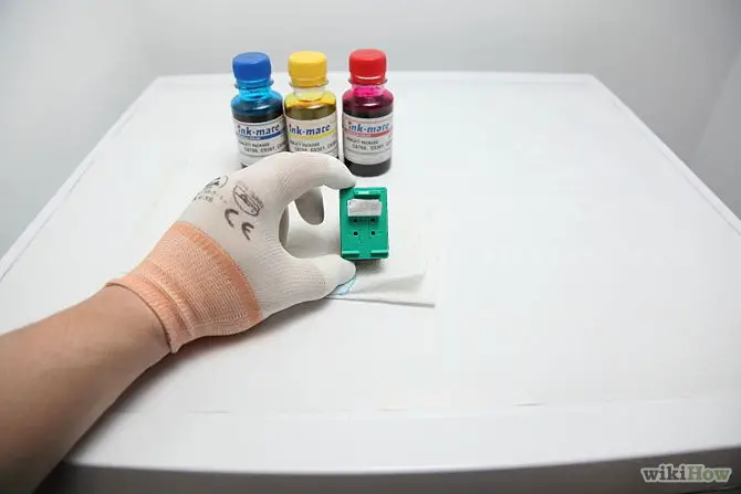

3. After removing the cartridge, gently peel away the sticker at the top of the cartridge to locate the holes for refilling the ink.
Precaution: It is best to wear disposable rubber gloves in order to prevent ink from staining your hand.
Precaution: Please ensure that the materials you are using are placed on a flat surface. This is to prevent the ink from spilling.

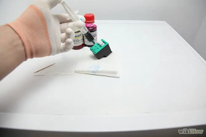

4. Now you need to fill the syringe with the ink you need to put in the cartridge.
Precaution: Before the syringe can be inserted into the cartridge, use a needle or toothpick to punch through holes on the top of the cartridge.
5. Place the point of the syringe into one of the refill holes and gently release the ink into the cartridge by pressing the top of the syringe.
6. Pump enough ink to fill the cartridge.

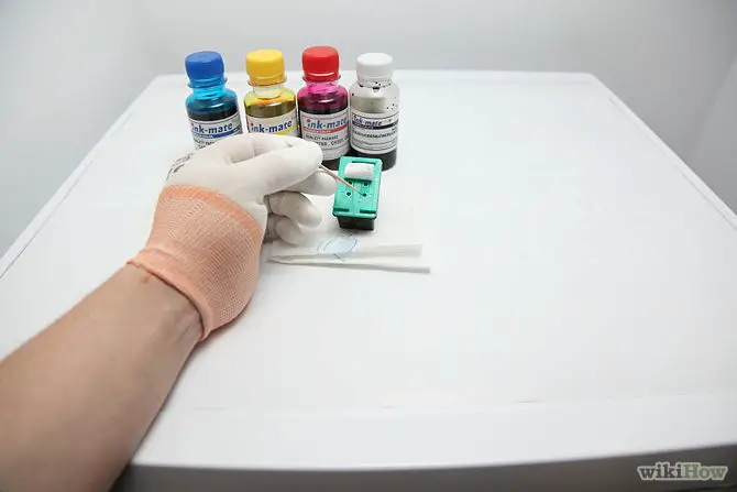

7. Once filled, replace the sticker that covers the refill holes.

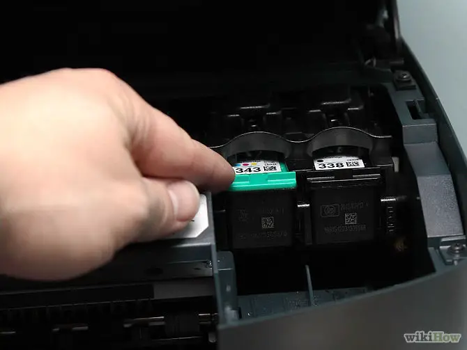

8. Place ink cartridge in printer and you are done.
Precaution: when placing ink cartridge into printer, go gently as parts may break.
