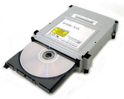

If that’s what’s happening to your CD-ROM drive, unfortunately, there’s no way you can fix it because, most of the time, the problem there is the little button that you press to eject the disc. That small button needs to be replaced but I’m not sure where you can buy that kind of switch.
CD-ROM drive
If you know an electronic shop that sells the same kind of push-button switch, you can probably buy one. But still before you can replace that button it requires a little knowledge about soldering electronic parts. If you don’t know how to solder an electronic device especially small ones it is not possible.
Even if it is hard to eject the disc from the drive, there is still an alternative way aside from pressing the eject button. If the eject button doesn’t work, you can use the small hole near the eject button to eject the disc from inside.
You need to insert a very thin pin on the hole and push it in the same way you press the eject button. There is a small lever in front of the hole inside. When you press the pin the lever will move pushing the disc out. On the other hand, if you don’t want to do this frequently, you should replace your drive with a new one.
