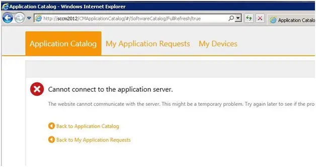

I am trying to install Microsoft System Center 2012 on a vm machine but when I try to run it after installation I get the following error I don’t know what am I missing in the installation process any guide will be helpful.
Application catalog Cannot connect to the application server. The website cannot communicate with the server. This might be a temporary problem. Try again later to see if the pro

First of all verify if WCF (Windows Communication Foundation) is installed with HTTP activation. Sometimes this error comes, when WCF is not activated.
OR
You may need to enable .NET 4.0. Run this command
 %windir%Microsoft.NETFramework64v4.0.30319aspnet_regiis.exe –i –enable
It will enable .NET Framework version v.0.30319 on a 64 bit computer
OR
Check the properties of the Site System and check the intranet name of the server. Make sure that the intranet address stored in the system should match the server address. The error could be due to two different FQDN addresses
