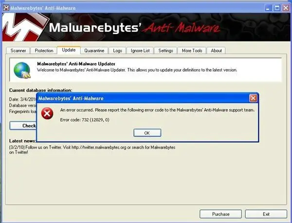

This is the first time that I have installed Malwarebytes Anti-Malware.
Right after that, I wanted to check if there were available updates before running my first scan with the new program that I have just installed. While trying to update it, the program obtained an error code 732.
Please provide steps and information to resolve this issue.
Error:
An error occurred. Please report the following error code to the Malwarebytes' Anti-Malware support team.
Error code: 732 (12029, 0)

Hi.
If you are experiencing error codes, 732, this characteristic means that the program version of Malwarebytes Anti-Malware is not current, and is too old to contact our update servers. The solution for this is to install a current program version. You can install this over the top of the existing program. Installing over the top will preserve your settings.
1) Click on link https://www.malwarebytes.com/mwb-download/ to start. You will then be forwarded to one of numerous download sites. On the other hand, to download from FileHippo.com
https://filehippo.com/download_malwarebytes_anti_malware/.
Bleeping Computer:
https://www.bleepingcomputer.com/download/malwarebytes-anti-malware/?1
FileForum / Betanew:
https://fileforum.betanews.com/detail/Malwarebytes-for-Windows/1186760019/1
2) If you get a prompt asking you to Run or Save the file, click Save and save this file to the desktop.
3) Double click mbam-setup.exe and follow the prompts to install the program.
4) At the end, make sure a checkmark is to be found next to the following:
    Update Malwarebytes Anti-Malware
    Launch Malwarebytes Anti-Malware
5) And then click Finish.  If an update is placed, it will download and install the latest version.
