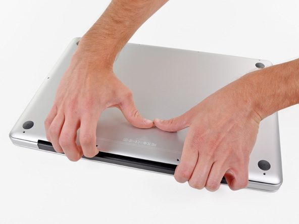

  • Unscrew the bottom case –
    • Remove the following ten screws securing the lower case to the upper case: Three 13.5 mm Phillips screws, Seven 3 mm Phillips screws.
  • Wedge your fingers between the lower case and the vent, and lift upward to release the clips holding the lower case to the upper case.
  • Remove the lower case.
  • Whenever working near the logic board, it is always wise to first disconnect the battery to avoid short circuits.
  • Grab the plastic tab attached to the battery connector and pull it toward the front edge of the device.
  • Pull the tab parallel to the face of the logic board
  • Wait 5 minutes and plug the battery back in and replace the bottom case
