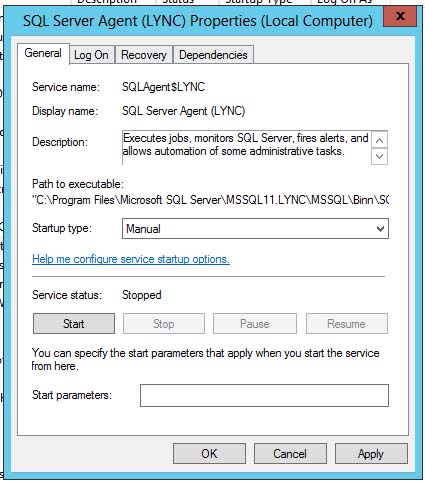

If you will check its properties, you will see that this service is set to Manual. See image.

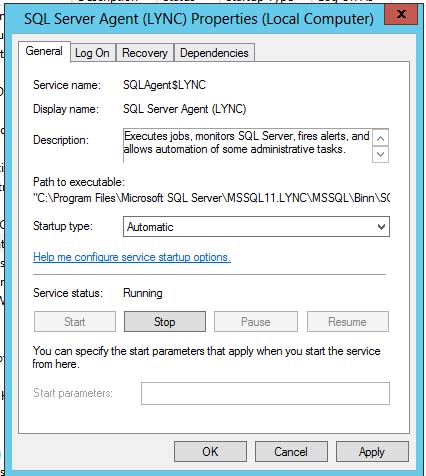

To fix this issue, you just need to change the “Startup type” of the service from Manual to Automatic and then click Start to start the service. See image.
Note that if you have configured an SQL Mirror, you need to do the same thing on the other server in the mirror. It also applies to SQL clustering. It should fix the problem and the error will never appear on the dashboard again because the SQL Server Agent service starts the stored procedure automatically.
