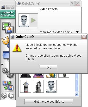

Logitech: Video Effects are not supported with the selected camera resolution
Unfortunately, caused by possibly Quick Cam and IE7 compatibility difficulties, as well as software design concerns, my personal playtime ended up being truncate. I attempted all day to create film Consequences lineament to be effective, as well as using Quick Cam v10.5.one particular develop 2029 (latest variant during this short article) didn't guide.
Afterward, we found that I'm not entirely alone, because there are at the very least a couple of testimonials bringing up your quirks of the online video Outcomes lineament with Logitech's Speedy Camera software.
Can someone please help me with this error?
Thanks
Video effects are not supported with the selected camera resolution
Change resolution to continue using Video Effects.
Answered By 590495 points N/A #150397
I think your camera here is set to use a higher resolution that is not supported by the video effects that you selected. You just need to change the camera’s screen resolution and select a different size. If your camera is set on a higher screen resolution, try lowering it down and select a much lower setting. Continue on selecting a different resolution until the video effects already accept it.
If you have already exhausted all possible settings and resolutions for the camera and it still doesn’t work, try updating your camera’s driver. Or, if your camera is already using the driver’s latest version, try uninstalling the program you are using then check your computer for any possible errors. Use a disk utility application to check the system. After that, install the application again and then try it after the reinstallation.
