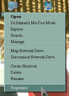

  • Right-click My Computer then select Properties.
  • Click Advanced tab.

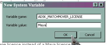

  • Click Environment Variables.
  • Under System variables, click New.
  • In Variable name, type ADSK_MATCHMOVER_LICENSE. In Variable value, enter Maya then click OK all through out.
There are 3 possible values that can be entered in Variable value:
  1. Softimage
  2. 3dsMax
  3. Maya
These values are case-sensitive.
When entering these values in the field, follow the exact casing above.
