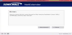

From a couple of days ago, I’m facing an error called SonicWall Certificate Error. So, please tell me something about this error. What is SonicWall Certificate Error? Reply to me as soon as possible. Thanks in advance.

These are the certificate errors shown up while accessing the SonicWall (using Internet Explorer).
Following error messages are displayed with the default SSL certificate of the SonicWall:
  • Untrusted Certificate
  • Certificate Invalid
  • Mismatched Address
On the certificate, it shows a red cross and also invalidates it, when you view certificates. This error message is IE’s normal behavior with the SonicWall’s default certificate (IE does not treat SonicWall as a trusted CA). Following are the steps you to fix this error:
  • Firstly, click on the browser’s address bar and then on Certificate error.
  • Then, go through View Certificates. After that, select the Install certificate.
  • The Window of ‘Welcome to the Certificate Import Wizard’ will appear on the screen. Select Finish (next window).
  • After closing the browser, open a fresh browser window.
