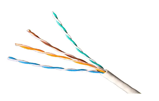

Learn About How Long Can A Cat5 Cable Be
Hi. What is the advantage of cables over wireless networks? Also, I want to know how long can a cat5 cable be? Please reply ASAP. Thanks in advance.

Hi. The advantage of using cables is that it provides a much faster speed than wireless networks. The answer to how long can a cat5 cable be being 90m or 295 ft in length. Cables with a longer length are available too, but these are not suggested as problems arise with them at a later stage. A cable with a longer length must be a fiber optic cable. However, if you are using a cable in the range of 295ft to 590 ft, then repeater is the best option which can be a switch or a hub. Ensure that cables on both sides of the repeater are equal in length. If the length of the cable exceeds 590 ft, then, a fiber optic cable should be used. This fiber optic cable can be protected using an armored fiber optic cable.

If you want to setup a local area network, the maximum length that a CAT-5 cable can have is 100 meters. This is what the CAT-5 Ethernet specification rules. In case you need to install a cable longer than 100 meters, you need to install a repeater, like for example a hub or a switch, which allows you to extend the total length.
