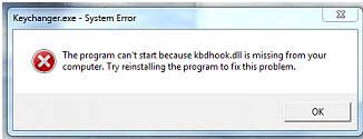

I am receiving the following error window on starting my Windows 7 computer, and I don’t know which program is causing this error to appear. How can I identify it?
Please help me get rid of this.
Error:
Keychanger.exe – System Error
The program can't start because kbdhook.dll is missing from your
computer. Try reinstalling the program to fix this problem.

If you are receiving this error on starting up Windows 7, the problem has something to do with one of your startup programs called “Key Changer.” The error is triggered by “Keychanger.exe” because the application is missing a file called “kbdhook.dll”. To fix the problem, simply reinstall your Key Changer program. This should restore the missing file back to its original location.
In case the missing DLL file is not really missing but the program is still triggering this error, it indicates that the file is corrupt. Reinstalling the program will also fix the problem. If you no longer have the installer for the program, unfortunately, you need to uninstall it to remove the error during startup. Click “Start,” “Control Panel,” and then “Add or Remove Programs.”
Scroll down and select your Key Changer program and click “Uninstall” or “Remove” then follow the instructions. Restart your computer if you are prompted. This should fix the problem.
