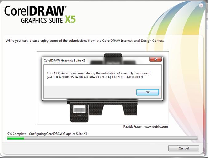

I am frustrated with the error I get to install CorelDraw. It says that there was an error during the installation of the Suite because of the assembly component.
I do not have any id the application.
CorelDRAW Graphics Suite X5
Error l935: An error occurred during the installation of assembly component

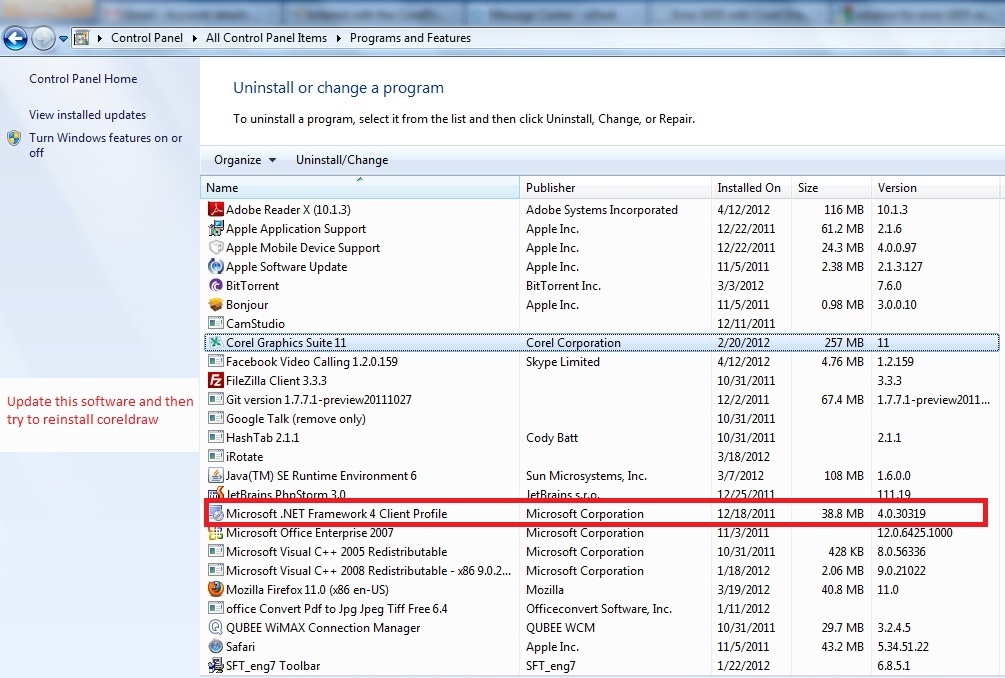

Many People get this issue especially related to MS products, error 1935 with Assembly Component are occured with MS office too, There are two solutions for it.
1) Repair/Update your Microsoft .Net Framework software and then try again to install the Corel Draw.
2) Second Solution is the Assembly Component error occur due to AVG software. But you need to Try the first solution it will work fine.
