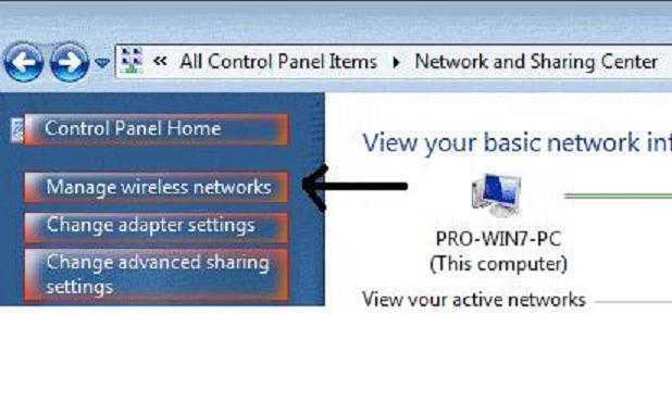

1. On your computer, click on the wireless icon on your system tray and open Network and Sharing Center.
2. Click on the Manage wireless networks and Remove your preferred networks under Networks you can View and Modify.
