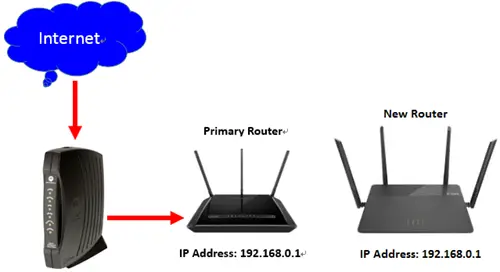

Hello. I was thinking of connecting 2 WiFi Routers. But I have no idea How to connect the 2 WiFi Routers? Please help me with this. Thanks in advance.

Hello. How to connect 2 WiFi Routers in detail explanation can be read below:
For Router 1:
Firstly, normally set up router 1. Disable Automatic Channel selection and also set the channel to channel 3 (manually) in the wireless security settings of the router.
For Router 2:
This router must be wired (in most cases). Consider a wireless media bridge in this case to the other location.
  • On this router to prevent network configuration issues by allowing Router 1 to manage the network by disabling the DHCP server.
  • Set the IP Address of this router to number one higher than the main router (manually). For DHCP distribution, make sure that this address is out of the 1st router’s allotment of addresses.
  • Select the Internet Gateway of router 2 to router 1 (IP address).
  • From any of port 1-4 in router 1, connect the two routers (via a wired connection) to any of port 1-4 in router 2.
  • After disabling the Automatic Channel selection of this router, manually set the channel to channel 8.
  • Select wireless security the same in router 2 as it is in router 1.
