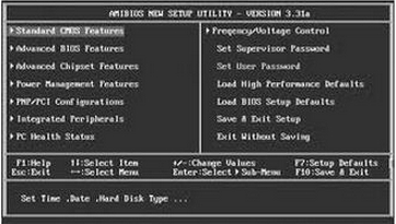

If that did not solve the problem, a self-started POST (power on self-test) might be necessary. Whenever a computer loads, it runs a POST. This runs through the basic hardware of the system to ensure everything is in working order especially when it comes with the motherboard.
The information that runs down your screen during the booting process is this POST in action. While this is running, you can hit F2 or delete, depending on the system, and enter the BIOS itself.
While you are in the BIOS screen, make sure you are careful not to save the information unless you truly know it is the right course of action. If you accidentally change system settings without knowing what you are doing, you will cause much more harm than good.
You change how the system loads, how the POST runs and many other features when in the configuration screen. In many cases, you can also update your BIOS to the latest version by visiting the manufacturer's web site and downloading an upgrade. Sometimes, this is the safest way to ensure your computer is running up to par.
