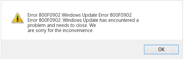

What is the 800f0902 error? Explain the error code briefly and show the steps to fix this error code, and add the snapshot of the error.

Error 800f0902 is a transient error because the update installer is busy processing requests from another client. Another reason behind the occurrence of the error is that the user is trying to install older updates. The solution to resolve the error code is as follows:
Solution 1:
Initializing Internet Explorer.
If the user is using any third-party browser, then it becomes the cause of the error; try to install the updates with the primary browser.
Solution 2:
Restart Windows Module Installer service (trustedinstaller.exe)
Step 1: Hold Windows key+ R and type service.msc then press Enter.
Step 2: Find Windows Modules Installer and right-click on it, then select Properties.
Step 3: Select the General tab and click on the Stop button.
Step 4: Click on the Start button to restart it. Now, hit Apply to confirm and close the service window.
