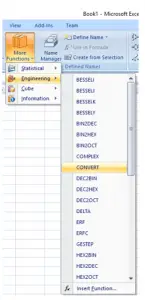

There is a pre-defined function to convert the value from one unit to another.
Step1. Populate your sheet with the values.
Step2. Select the values you want to convert.
Step3. Select more functions > engineering > convert.

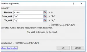

Step4. Provide the unit from and to which you want to change.
Step5. Click OK. The value is changed.
