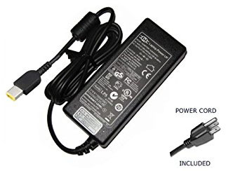

Normally, when you plug the charger to the power and connect the charger to your laptop, the LED indicator on the laptop will immediately light up even if the laptop is turned off. But if the LED doesn’t activate after connecting the charger, there must be something wrong with your charger or there is no power on the outlet where you plug the charger.
Lenovo charger
Check if there is no problem with your power. Try to turn on the lights to verify that there is electricity. If there is no problem with the power, transfer the charger to another power outlet and see what happens. If your laptop still doesn’t charge, try connecting the charger to another laptop and see what happens.
If the other laptop powers up, there is a problem with the power supply of your laptop. You should bring it to a qualified service center for proper servicing. But if the other laptop also doesn’t charge, you probably need to replace your charger.
