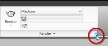

Answered By 0 points N/A #198385
How to render AutoCAD 2012 PDF file?
In order for you to render your AutoCAD file to your PDF file, you have to Click the render tab on the ribbon and click the Advance Render Settings button (Small arrow on the edge to view the whole panel).
On the General Tab > Render Context > Output file name section, click the ellipsis or three dots.
On the dialog box, look down below on the files of types and select pdf, click ok and the file is ready on the pdf file.
