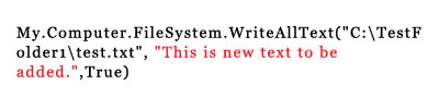

Write a text to a document or  file by using WriteAllText Procedure, and simply noting the text and documents that you want to write.You will see that the  “This is new text” line  is written into the document test.txt, this will allow the  new text  to join the current and existing text in the file.
See the example below 2nd  image.
