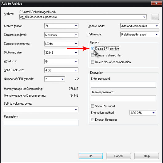

In 7-Zip, to create a self-extracting archive, open 7-Zip and then select the file or files to compress. In the “Add to Archive” dialog box, check “Create SFX archive”. Configure your compression parameters and then click OK. Once the compression is finished, the resulting archive is a self-extracting file. It no longer needs the help of 7-Zip to unpack its contents.
Just run the file and it will automatically extract or unpack its contents to a desired location or folder. If you wish to download 7-Zip, visit 7-Zip File Compressor.
