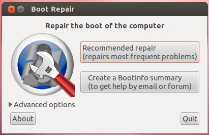

(a) On your machine after having finished installing windows, boot from Ubuntu Disc.
(b) In the menu that appears on booting, select the option " Install and Run Boot Repair".
(c) Then click on "Recommended Repair" After it finishes its operations, reboot the system, the Grub menu with options to use both operating systems should appear.
