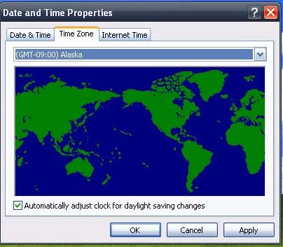

I set the Internet time to automatically synchronize with an Internet time server and set the server to time.windows.com, then clicked on update now. I switched on the server to time.nist.gov but either way, I have no luck. I already set the time zone correctly, but every time I shut down and restart my computer, the time zone will change its value again.

From the screen shot that you've attached in this question, I see that you have checked – automatically synchronize with an Internet time server and also checked – automatically adjust clock with daylight saving change. Please remove this settings and press, OK.
If this did not work, please check your BIOS time settings. If it is wrong, please correct it and reboot the computer again.
