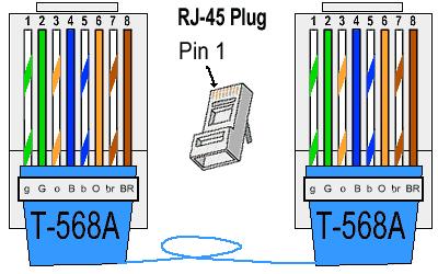

For crossover cable you must use it in the PC-PC connection. That is not for you. You want to connect switch-PC for that you have to use straight-through connection. There are 8 pieces of wires in a cable. If you connect in any configuration in one side you must have to use the same configuration in other side.
That’s how you will make a straight cable. All done now.

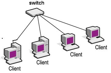

The very first thing you need is a central connecting device that is simply a ‘LAN switch’. Buy a switch having 16 or more ports. As far as the cable is concerned twisted pair cable CAT6 (category 6) is best for LAN connections.
It has 8 cables of different colors inside and needs RJ-45 connectors on both sides so you will need 32 connectors accordingly. For connection between PC and switch straight cable will be used which means on both sides color sequence is same. See diagram 1.
For connecting computer see the 2nd diagram.
